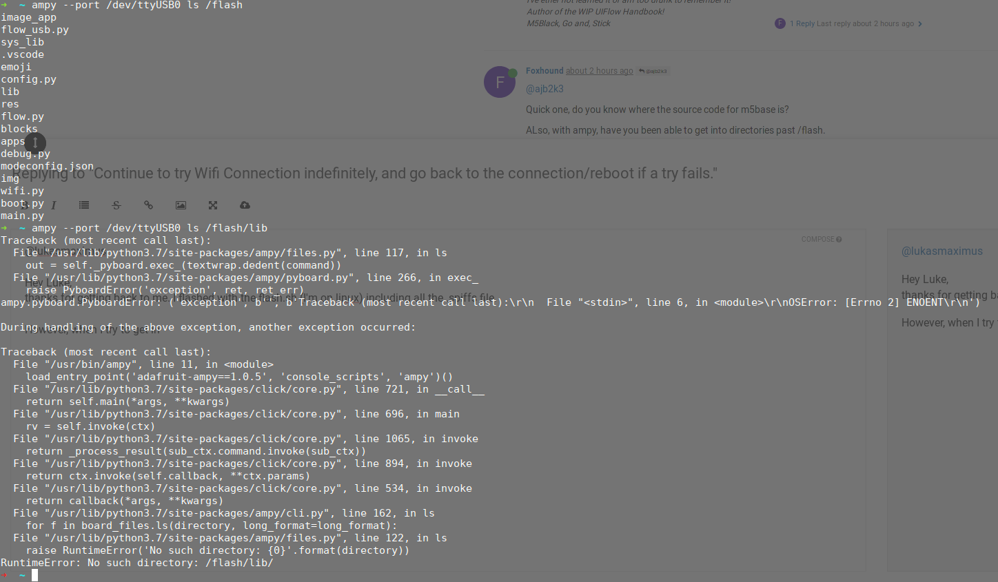

                                Quick one, do you know where the source code for m5base is?
                                ALso, with ampy, have you been able to get into directories past /flash.
                                WHenever I try and list things inside say lib(/flash/lib), it say it isn't a directory?

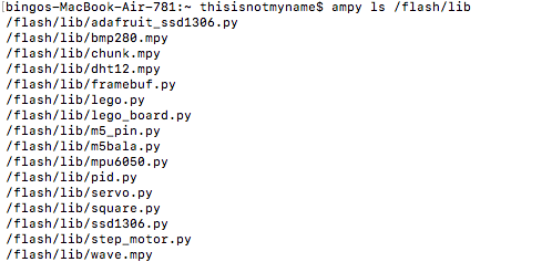

                                  lukasmaximus
                                  • lukasmaximusL
                                    lukasmaximus
                                    which micropython version are you using? if you did a custom flash not from the official m5stack burner you may have forgotten to flash the .spiffs file which contains all the folders and files you want to put on the filesystem

                                      Foxhound
                                      @lukasmaximus
                                      Hey Luke,
                                      thanks for getting back to me. I flashed with the flash.sh (I'm on linux) including all the .spiffs file.
                                      However, when I try to get I get the following.
