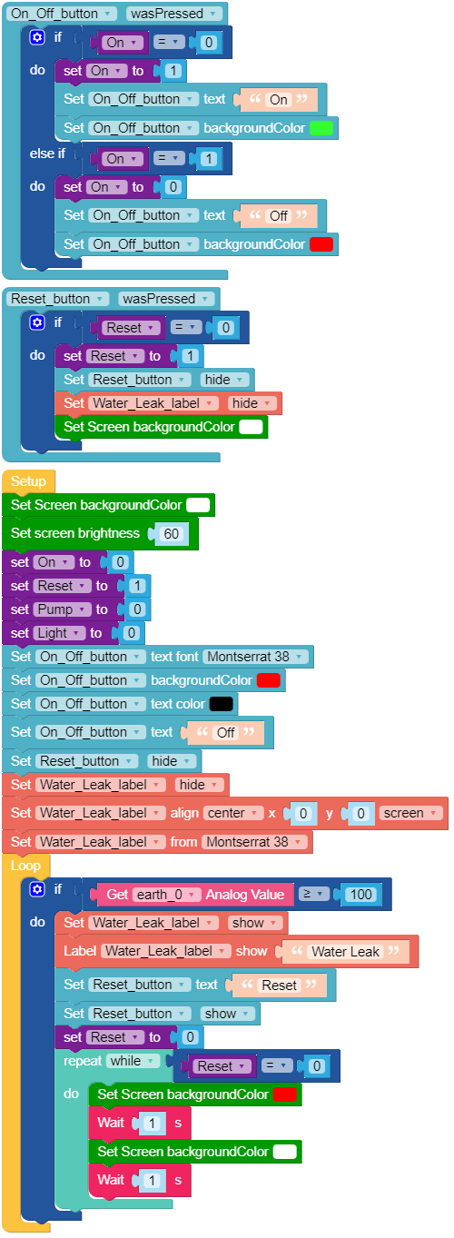

<p dir="auto">motor module</p>
<p dir="auto">No worries on the cap sensor. It works reliable with analog and a low threshold. I'm using a DC diaphragm water pump that I'll be running with a mosfet speed controller. Here is where I got to last night.</p>
<p dir="auto"><img src="/assets/uploads/files/1691574647404-uiflow_block_main_page.png" alt="0_1691574661223_uiflow_block_Main_Page.png" class=" img-fluid img-markdown" /></p>
<p dir="auto">I need to add a speed controller and a SSR relay...I feel like I'm forgetting something. Last night was not a good night for productivity nor thinking. Sorry.</p>

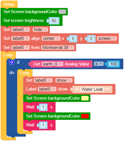

<p dir="auto"><img src="/assets/uploads/files/1691477032532-uiflow_block_1691477020498.png" alt="0_1691477046780_uiflow_block_1691477020498.png" class=" img-fluid img-markdown" /></p>
