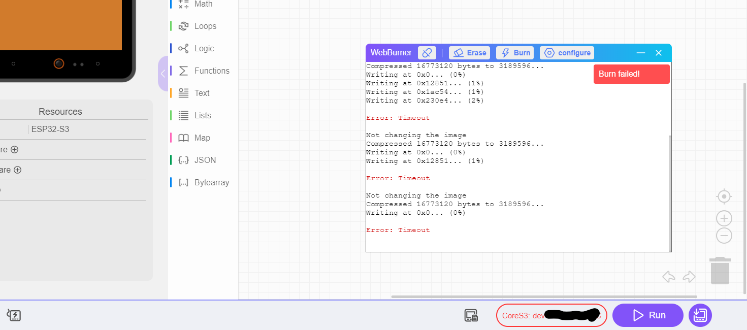

The CoreS3 button is permanently Red to the left of the Run button.<br />
I also tried the Burn button and that keeps timing out.<br />
<img src="/assets/uploads/files/1689998265412-burnfail-resized.png" alt="0_1689998263534_burnfail.png" class=" img-fluid img-markdown" /></p>

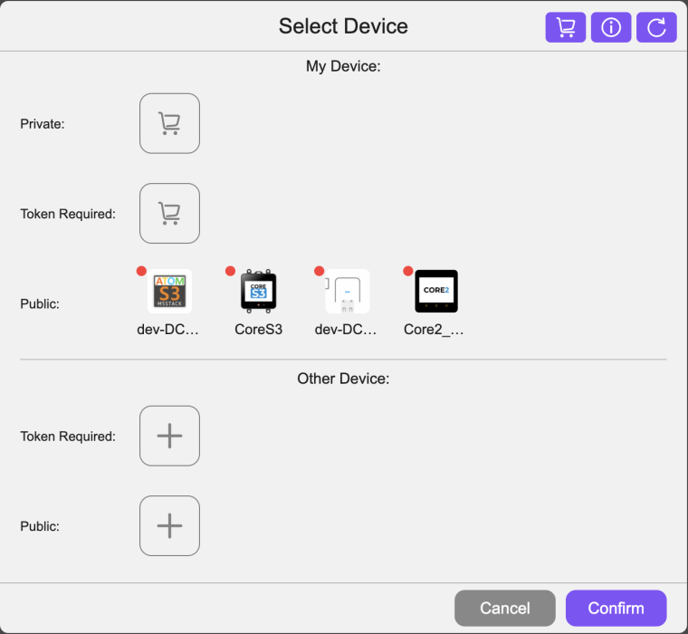

<p dir="auto">Click the red button to open device selector, then click on any devices in there and delete them by clicking on them<br />
<img src="/assets/uploads/files/1690611279498-screenshot-2023-07-29-at-07.14.26-resized.png" alt="0_1690611287177_Screenshot 2023-07-29 at 07.14.26.png" class=" img-fluid img-markdown" /></p>

Every time I try download a program a Loading... popup message appears in the top right of the screen<br />
Then a message either Execute Program Failed (from the Run button)<br />
or Download Program Failed (from the Download button)<br />
I can flash the demo software no problem.<br />
I can flash the UiFlow from the burner app<br />
and I get the uiflow menu<br />
I cant download any uiflow program to the device.<br />
I've tried logging out and logging back in<br />
I'm just trying to save a simple ui with the background set to blue.<br />
Every time I tried to download the uiflow program it gives the same timeout message.<br />
I've tried holding the bottom button down until the green light comes on.<br />
And saving first before sending.<br />
I think its the fact the red button to the left of Run is never being changed from Red unless I logout then it says select device.<br />
When I log back in and choose the device it goes to red again.</p>
<p dir="auto">This all happened when uiflow 19 was updated.<br />
Ive tried installing 19 again, and 20 and 21 but still not working.<br />
Ive tried erasing the flash from uiflow and from burner.</p>
<p dir="auto">Its really frustrating.</p>

Try deleting the coreS3 in UIFlow and then repairing in M5Burner.</p>
