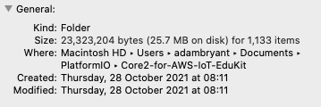

<p dir="auto">The other reason I wouldn't think that was the root cause is because my personal laptop, work laptop, and our test instance in EC2 are all using different versions of macOS and they say "Macintosh HD" as the label for the OS drive and I haven't seen this issue due to that.</p>
]]></description><link>https://community.m5stack.com/post/15293</link><guid isPermaLink="true">https://community.m5stack.com/post/15293</guid><dc:creator><![CDATA[rashedtalukder]]></dc:creator><pubDate>Fri, 29 Oct 2021 20:24:54 GMT</pubDate></item><item><title><![CDATA[Reply to Error: Detected a whitespace character in project paths. on Fri, 29 Oct 2021 20:12:46 GMT]]></title><description><![CDATA[<p dir="auto"><a class="plugin-mentions-user plugin-mentions-a" href="/user/rashedtalukder" aria-label="Profile: rashedtalukder">@<bdi>rashedtalukder</bdi></a> said in <a href="/post/15286">Error: Detected a whitespace character in project paths.</a>:</p>
<p dir="auto">I don't see the whitespace character. Have you tried just moving the project folder to a different location?<br />
The "White Space" is there in "Macintosh HD" managed to get my system to remove the space between Macintosh and HD and it works without my OSX crashing (OSX created the name Macintosh HD</p>
]]></description><link>https://community.m5stack.com/post/15292</link><guid isPermaLink="true">https://community.m5stack.com/post/15292</guid><dc:creator><![CDATA[ajb2k3]]></dc:creator><pubDate>Fri, 29 Oct 2021 20:12:46 GMT</pubDate></item><item><title><![CDATA[Reply to Error: Detected a whitespace character in project paths. on Fri, 29 Oct 2021 18:35:04 GMT]]></title><description><![CDATA[<p dir="auto">I don't see the whitespace character. Have you tried just moving the project folder to a different location?</p>

<img src="/assets/uploads/files/1635427332691-screenshot-2021-10-28-at-14.21.33.png" alt="0_1635427332132_Screenshot 2021-10-28 at 14.21.33.png" class=" img-fluid img-markdown" /></p>
