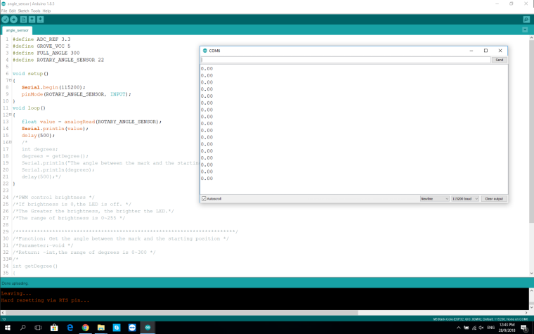

      Do you mean changing "#define ROTARY_ANGLE_SENSOR 22" to "#define ROTARY_ANGLE_SENSOR 21"?
      I changed 22 to 21 but there is no difference except digitalread() of 21 is always 1.

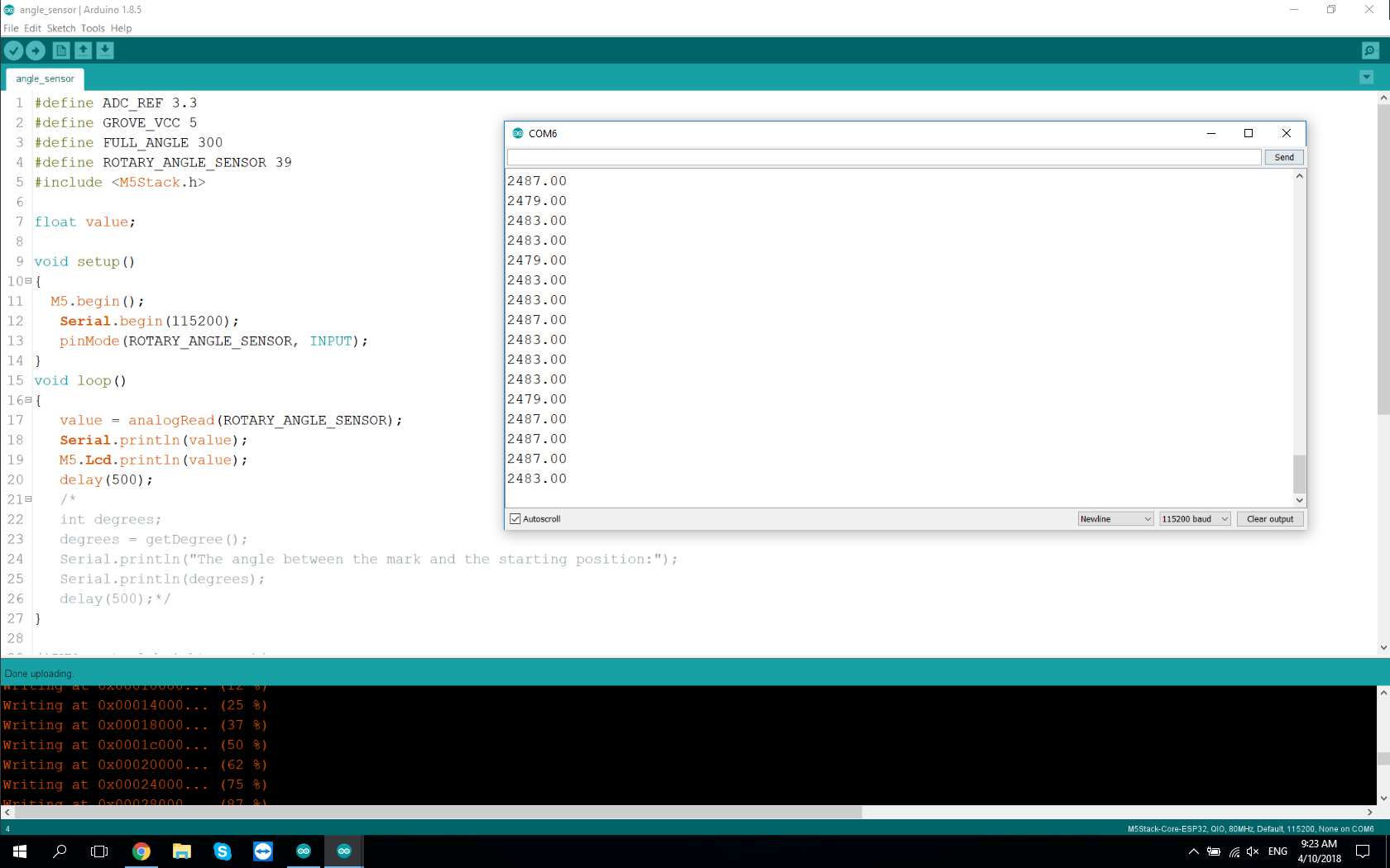

        @ken57093 gpio22 in NOT on pin 22 gpio is on pin 49 according to the datasheet
        Opps there are only 48 pins. the define should be 39!
        #define ROTARY_ANGLE_SENSOR 39
        K 1 Reply Last reply Reply Quote 0
        • K
          ken57093 @ajb2k3
          @ajb2k3
          Thank you.
          I had tried. There is no change when i steer the sensor, but the value will sometime auto change itself.
          • ajb2k3A
            ajb2k3 @ken57093
            @ken57093 , sorry, will try setting up a test rig and test.
            Haybin said to try 36!
            • K
              ken57093 @ajb2k3
              @ajb2k3
              I had tried before. The output of 36 is similar to 39.

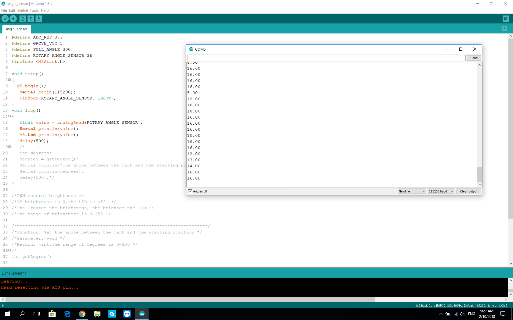

                @ken57093 在 How to use the angle sensor? 中说:
                Ok, set up my test rig and getting the same results.
                This is my code and I think something is missing.
                #include <M5Stack.h>
                /macro definitions of Rotary angle sensor and LED pin/
                #define ROTARY_ANGLE_SENSOR 36
                #define LED 3 //the Grove - LED is connected to PWM pin D3 of Arduino
                #define ADC_REF 3.3 //reference voltage of ADC is 5v.If the Vcc switch on the seeeduino
                //board switches to 3V3, the ADC_REF should be 3.3
                #define GROVE_VCC 3.3 //VCC of the grove interface is normally 5v
                #define FULL_ANGLE 180 //full value of the rotary angle is 300 degrees
                void setup()
                M5.begin();
                Serial.begin(9600);
                pinMode(ROTARY_ANGLE_SENSOR, INPUT);
                pinMode(LED,OUTPUT);
                void loop()
                float voltage;
                int sensor_value = analogRead(ROTARY_ANGLE_SENSOR);
                voltage = (float)sensor_valueADC_REF/1023;
                float degrees = (voltage
                FULL_ANGLE)/GROVE_VCC;
                Serial.println("The angle between the mark and the starting position:");
                Serial.println(degrees);
                • ajb2k3A
                  ajb2k3
                  OK analogue read does not work, the command is something like ADC1 get raw (or some such)

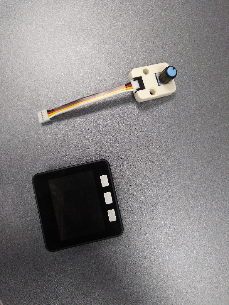

                            My apologies guys, I presumed you were using the m5go or fire as I am. If you are using the gray or black core models you will need to use jumper cables to attach the angle sensor to the pins on the bottom of the core as shown in this picture. it is not possible to connect the angle sensor to 22 or 23 as they are digital inputs, for the angle sensor we need an analog input or ADC (analog to digital converter) pin, so this is only possible on pins 35 and 36. try to connect as I show in these pictures and try again, it should display the numbers on both the serial monitor and the screen.![](http://imagehosting.biz/image/6ut

                              ken57093 @lukasmaximus
                              @lukasmaximus
                              Thank you. I will try it again after buying the wire
