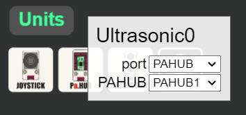

<p dir="auto">I only have an ENV and Ameter unit and I can use them together just fine with the Pa.HUB and M5Core2.</p>
<ul>
<li>Do the units work ok, when used w/o Pa.HUB?</li>
<li>Does a single unit work on all ports of the Pa.HUB?</li>
<li>Are you sure you have your units connected to the correct ports?</li>
<li>Did you try to reset M5Core2 in case some previous code is running?</li>
</ul>
<p dir="auto">If it's only some units that fail I am afraid I cannot help as I don't have any other units to test with. Sorry.</p>
<p dir="auto">Thanks<br />
Felix</p>

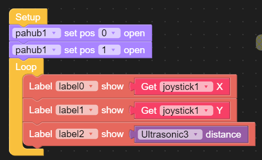

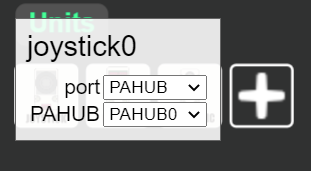

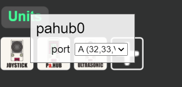

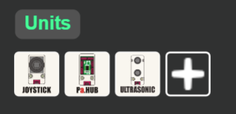

It's the same with other I2C units</p>
<p dir="auto"><img src="/assets/uploads/files/1616005926280-6d24ce61-d397-43a3-9088-7b79d33ed7f6-image.png" alt="0_1616005925603_6d24ce61-d397-43a3-9088-7b79d33ed7f6-image.png" class=" img-fluid img-markdown" /></p>
<p dir="auto"><img src="/assets/uploads/files/1616005750453-4f18a371-0bcc-4361-9482-122db643e218-image.png" alt="0_1616005750021_4f18a371-0bcc-4361-9482-122db643e218-image.png" class=" img-fluid img-markdown" /><br />
<img src="/assets/uploads/files/1616005954265-625ba321-1ef8-4b93-b823-a592b90a3e18-image.png" alt="0_1616005954120_625ba321-1ef8-4b93-b823-a592b90a3e18-image.png" class=" img-fluid img-markdown" /><br />
<img src="/assets/uploads/files/1616005975352-fb7d8ae1-0a5c-4c33-9357-e543dbe08f0a-image.png" alt="0_1616005975205_fb7d8ae1-0a5c-4c33-9357-e543dbe08f0a-image.png" class=" img-fluid img-markdown" /><br />
<img src="/assets/uploads/files/1616006010992-39b058a7-478e-4c57-89b5-b4c99780f945-image.png" alt="0_1616006010848_39b058a7-478e-4c57-89b5-b4c99780f945-image.png" class=" img-fluid img-markdown" /></p>

<p dir="auto">I think <code>set pos X open</code> is the wrong command. According to the help text it only opens <strong>one</strong> position and closes <strong>all</strong> others. Try <code>set pos X state open</code> instead.</p>
Felix</p>

<p dir="auto">I'd love to. Unfortunately I am just a user like you w/o access to UIFlow source code.</p>
<p dir="auto">Hopefully M5Stack engineers will look into that soon.</p>
Felix</p>
<p dir="auto">P.S. As a work-a-round in the Python tab you can modify the line for the unit connected to Pa.HUB manually. Not ideal but this works for me.<br />
E.g. from</p>
<pre><code>AMeter0 = unit.get(unit.AMETER, unit.PORTA)
</code></pre>
<p dir="auto">to</p>
<pre><code>AMeter0 = unit.get(unit.AMETER, unit.PAHUB0)
</code></pre>
