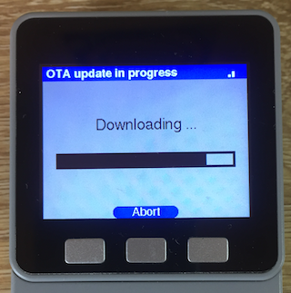

<p dir="auto">There are little things I want to make better still. It's not "done" - such things are never done - but you have to release at some point. But is good enough to build things on.</p>

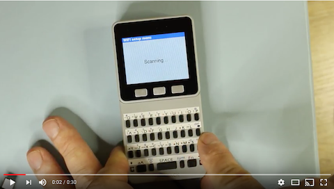

<p dir="auto">A video can say more than a thousand words: please watch the video and have a look at the Github repository.</p>
<p dir="auto"><a href="https://www.youtube.com/watch?v=qRbE3FXEWJQ" target="_blank" rel="noopener noreferrer nofollow ugc"><img src="https://rop.nl/M5ez.png" alt="" class=" img-fluid img-markdown" /></a></p>
<p dir="auto"><a href="https://github.com/ropg/M5ez" target="_blank" rel="noopener noreferrer nofollow ugc">https://github.com/ropg/M5ez</a></p>
<p dir="auto">As you will see I put some effort into documenting everything it does on Github. I hope you all will play with this and tell me what you like and don't like. I will continue to work on it and let you know in this thread when things are changing.</p>
<hr />
<p dir="auto"><em>( A big thank you to Calin for some of the ideas. )</em></p>
