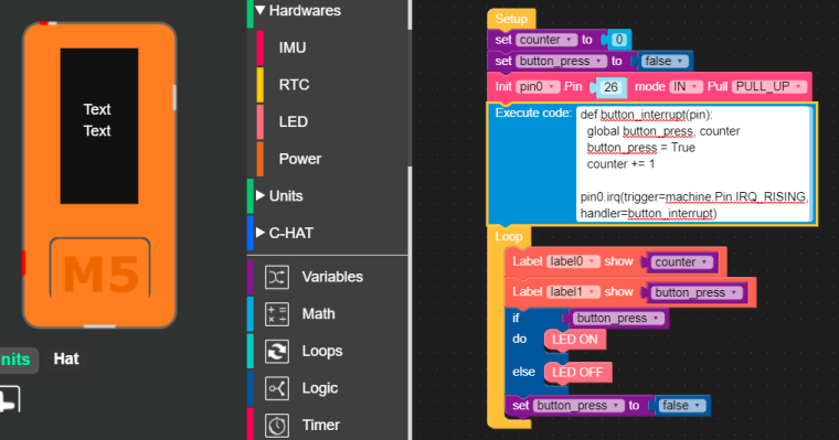

Below is an example of a N/O button interrupt, connected between G26 and GND.<br />
Counter increments multiple times per button push.<br />
This shows that software debounce could be necessary in many cases.<br />
Cheers - BillT<br />
<img src="/assets/uploads/files/1614130219009-interrupt-resized.png" alt="0_1614130213067_interrupt.PNG" class=" img-fluid img-markdown" /></p>

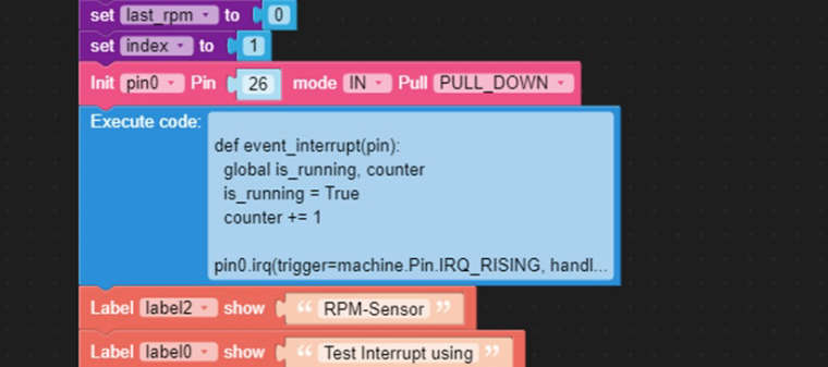

try an execute block, look at my code below.</p>
<p dir="auto">First i defined the two variables "is_running" and "counter".<br />
In UIFlow i defined pin0 with GPIO26 as input with pull down resistor.!<br />
Then i defined the event_interrupt(pin) - procedure. I use it for counting impulses at the GPIO26, therefore it is necessary to declare the variables as globals.</p>
<p dir="auto">Every second i read in the main loop the value of the counter variable and reset the is_running variable.</p>
<p dir="auto">def event_interrupt(pin):<br />
global is_running, counter<br />
is_running = True<br />
counter += 1</p>
<p dir="auto">pin0.irq(trigger=machine.Pin.IRQ_RISING, handler=event_interrupt)</p>
<p dir="auto"><img src="/assets/uploads/files/1595778122129-interrupt-resized.jpg" alt="0_1595778123207_interrupt.jpg" class=" img-fluid img-markdown" /></p>
]]></description><link>https://community.m5stack.com/post/9446</link><guid isPermaLink="true">https://community.m5stack.com/post/9446</guid><dc:creator><![CDATA[Gaviota]]></dc:creator><pubDate>Sun, 26 Jul 2020 15:48:59 GMT</pubDate></item><item><title><![CDATA[Reply to UIFlow digital input interrupt on Fri, 24 Jul 2020 23:53:27 GMT]]></title><description><![CDATA[<p dir="auto">50hz triac phase control with zero crossing timing synchronization. 100micro second timing tolerance or better. I ended up porting to Arduino/C++, too many limitations with UIFlow for now, python maybe to slow anyway. UIFlow is a good tool for higher level/basic control.</p>
