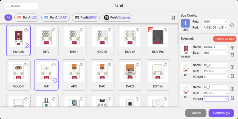

Ok so you need to have the code/libraries to both access the TOF sensors and the Host PAHUB controller.
I once wrote a guide on how to connect 2 TOFs via a PAHub to an M5Stack controller but it looks to have gone missing.
This is how the TOFs must be configured in UIFLow2.
Here is the Project Zone Link just for reading the 2 Time of Flight Units. https://uiflow2.m5stack.com/?pkey=bf8abdb1dd8c4e47b52de320c9206ecc
